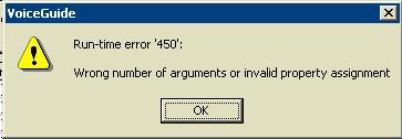

I just upgraded my VG 5.2.3053 to the VG for Dialogic version (6.0.1056). I followed all the instructions you provided in the email and am getting the following error when an inbound or outbound call is answered.
Run-Time eror '450':
Wrong number of arguments or invalid property assignment
When I click ok, VG closes.

Could you please post a copy of VoiceGuide's Debug Printout which captures the problem, this will allow us to see what is going on.
Can you please post the MMDDtw.txt log as well.
I suspect you may have a wrong version of ktTelControl.OCX on your system, but until we see the trace we cannot tell.
Attached OCX is the one that should be installed on the system for that version of .EXE
ktTelControl_050317.zip
The ktTelControl.OCX that you attached has the same 2.1.1.0 version number as the version that was emailed to me with the VG for Dialogic files except that it is 8K larger. I will try the attached version out and let you know how it goes.
Please try with OCX posted above.
If still does not work please post MMDDtw.txt trace again (from the new OCX).
OK, I put the "newer" ktTelControl.ocx in place and VG seems to work now. When I called in to test using the CreditCardPayment script the voice playback is in slow motion. What would be causing this?

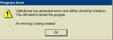

Also have another problem. When I add a phone number to the outdial queue using the number loader program I get a vgmulti.exe error. The call still goes through and everything seems ok. My wav files and TTS seem to play at the correct speed. Not sure why these work and the credit card sample plays slow.
If the VGMulti goes on making the call then I'm not sure what is causing this error, maybe its the Telephone Number loader program? or maybe one of the VBScripts in the VG script?
Does this error pop up as soon as you load in the number to be called?
What if you set the start time to be some time in future, does error still occur?
Yes the error pops up almost immediately after loading 1 number using the loader program. There are no VBScripts run in the VG script file until the end of the call. This error pops up before VG starts dialing.
I will have to try that and let you know. I will also try loading some numbers using the XML file which is what I normally do.
