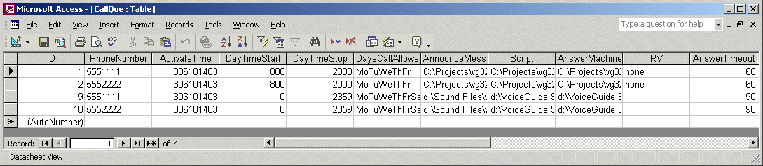

Activate time is in format:
YMMDDHHNN
So a value of 306101403 would mean "Dial this number on 10th June 2003, at 2:03 pm"
Note that you only use one digit to indicate the year.
I attach a screenshot which shows the DialList.mdb database after I just loaded some numbers into it to be called.
First two numbers were loaded using the VoiceGuide telephone number loader.
The next two were loaded using this DialListNew.txt file:
2:03 PM 10 June 03, 5551111, 3, 120, d:\Sound Files\welcome1.wav, d:\VoiceGuide Scripts\statequery.vgs
2:03 PM 10 June 03, 5552222, 3, 120, d:\Sound Files\welcome1.wav, d:\VoiceGuide Scripts\statequery.vgs
