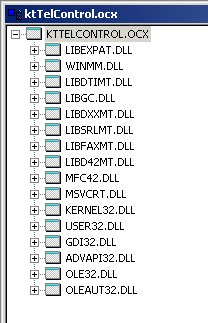

We have a Win2003 SBS as one of our test machines here, and the install works OK. Attached is a list of all the DLLs that ktTelControl.ocx requires. Please check if all of these files are present in the \System32\ directory.

These files are all in the specified directory. I am running Windows Small Business Server 2003 Premium Edition - no Service Packs. I am downloading SP1 to install on the machine. Maybe this SP installs some the .dll files that you indicated with a more recent date?
