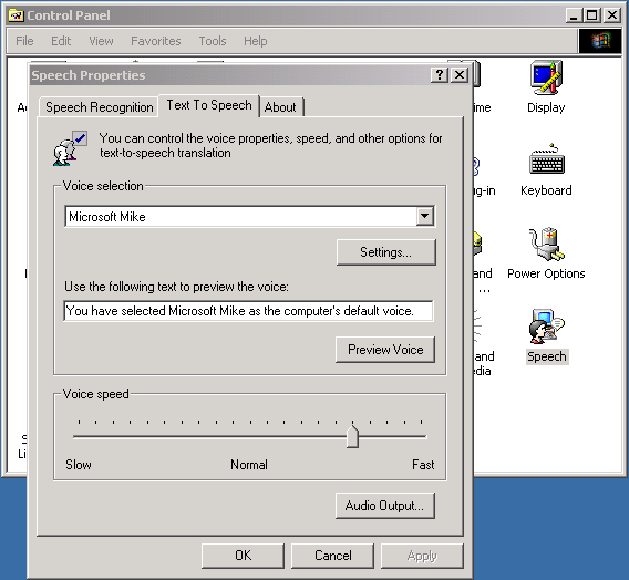

I have already made arrangements to purchase the Voice Guide software. But I need to know how to make it work with microsoft's TTS engine. Very little information was given about it in the help files. Though the help files indicate that the trial version which I am currently running should work with TTS.
Please help.
After installing TTS it just works... the only thing that needs to be selected is the preferred voice to be used (see attached screenshot).
