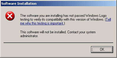

i have downloaded the eval and receive the attached message during install
it appears as if the entire app is installed and working, but the vb control is nowhere to be found, so the vb modules generate an error cant find library
i deinstalled and reinstalled a number of times
any clues?
i am running windows 2003 server enterprise

We were advised that on Win2003 you sometimes get this error pop-up. Apparently one Microsoft's own module's that we ship with VoiceGuide is creating this error, but the entire app does work fine, because Win2003 apparently has that particular module installed already (?).

Can you please post a screenshot or log of that error.
first of all i posted a screen shot. secondly IT DOES NOT work properly, like I said very clearly the vb control is nowhere to be found
The Windows Scripting Host comes with Win2003, so all the VBScript components should work despite Win2003 showing the message you posted.
