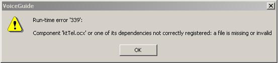

Hello Support,
I Installed VoiceGuide for Dialogic but I get the following error message: (See attachement)
What must I do?
