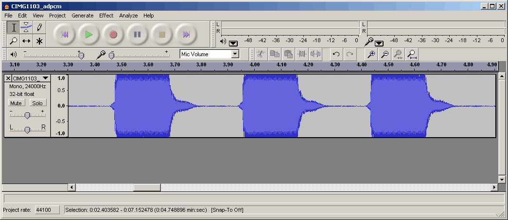

And when i disconnect the dialogic doesn't release the line, i tried to mesasure the frequency and on/off parameteres using the PBx expert but with no luck with the results.
I recorded the disconnection tone for you, and i appreciate if you can send me back the parameters.

The recording shows this is an unusual type of tone. The end of tone is not well defined, and it is composed of many frequencies, rather the one or two dominant frequencies.
The length of the ON section of the tone is about 200ms, but then the tone dies off over the next 100ms, so you could say length of tone is actually 300ms...
Overall cycle is about 480ms.

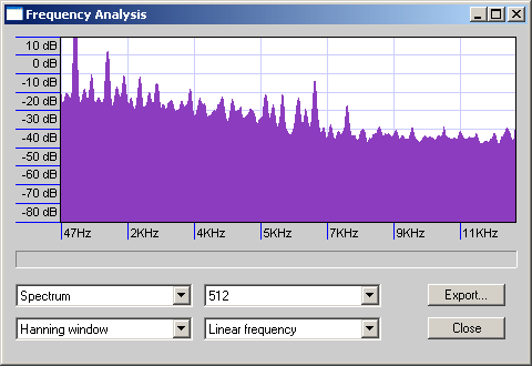

The frequencies are a real problem though. It's hard to say if just specifying 425Hz will be sufficient as it does not stand out that much from other frequencies (which are mostly it's harmonics).
