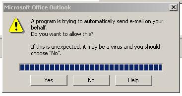

Guest Gulano Report post Posted 11/15/2006 03:47 PM Hello Support, Thanks for the files. When the caller press 1 it it OK. The caller can listen to his/her spoken message When the caller press 2 it it OK. The caller can record again This should be good for a system thats let people leave their problems. The option to save the message and exit was when you press the key 0. The system should save the message and exit. (very good) But the problem was that the system was sending 2 emails of the same. Now with the file you send, VG is existing the system but it's sends no email and no message. I am getting a message at my screen telling me that the system want to send a message. If I press "yes" no message is sending. The only problem whas that the system was sending 2 emails. When the caller press 8, the system send 1 email (very good) but it is going to voicemailbox menu. Can I leave it so to make the caller press 8 and then hang up? (It is not nice if the caller hear the message regarding voicemail) It is a problem reporting system. (I am sending you the logs) log1.zip when I press 8 log2.zip when I press 0 I hope you can help. Regards. It should be good Log2.zip Log1.zip Share this post Link to post
