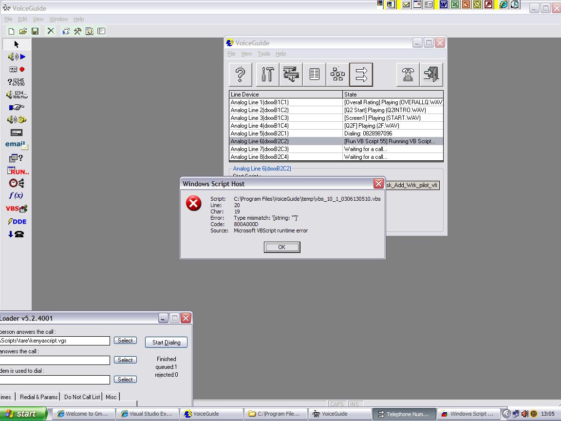

Guest DashboardResearch Report post Posted 03/06/2007 01:08 PM i have attached the picture of the error message i am getting after running this command, trying to put in the path makes even worse "command /c shntool join -stdout 1.wav 2.wav 3.wav > 1_2_3.wav" Share this post Link to post

Guest DashboardResearch Report post Posted 03/06/2007 02:26 PM i have a attached the file with file paths and its still giving me the same error "command.com /c shntool.exe join -stdout C:\Program Files\VoiceGuide\Scripts\tare\Q1.wav C:\Program Files\VoiceGuide\Scripts\tare\q2.wav> C:\Program Files\VoiceGuide\Scripts\tare\1_2_3.wav" kenyascript.zip Share this post Link to post
SupportTeam Report post Posted 03/06/2007 08:28 PM The paths have spaces in them and have not been surrounded in quotes. Try: "command.com /c shntool.exe join -stdout 'C:\Program Files\VoiceGuide\Scripts\tare\Q1.wav' 'C:\Program Files\VoiceGuide\Scripts\tare\q2.wav' > 'C:\Program Files\VoiceGuide\Scripts\tare\1_2_3.wav'" Notice how single quotes ' are used at beginning and end of each path. Share this post Link to post
