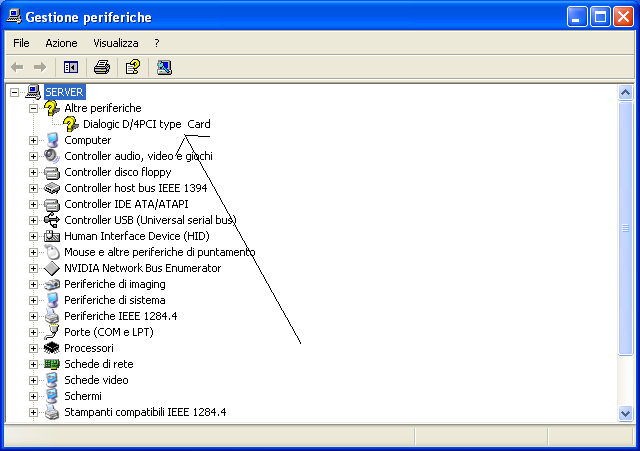

We have installed one D/4PCI
The voice Horoscope answer the call but I am unable to listen anything.
However the D/4PCI is not recognized in the Hardware Panel (see image attached), could be this the problem ?
Christina
If you cannot hear anything when the Dialogic's own sample/demo applications play as well then it looks like your card is faulty.
No. That does not affect card's operation.
