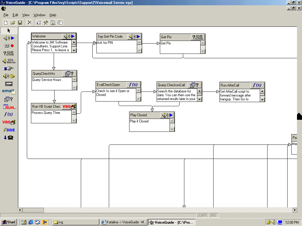

Guest SalC Report post Posted 08/25/2003 05:09 PM Hello. Same problem again with that version too. I have attached a screenshot of what happens. Notice the scrollbar at the right and also the menu bar at the top. The menu is a second line down from the top which is weird. I would consider this to be more then an anoyance since it is very difficult to work with large scripts. I also sent an email regarding that the registration code given to us does not work with 5.0a. but did with beta 19. Thanks again! Share this post Link to post
SupportTeam Report post Posted 08/26/2003 01:41 AM menu is a second line down from the top which is weird. This is the case right now if the Script window is maximized - we are aware of this issue and can see it on our test systems. Notice the scrollbar at the right Have not seen this before and cannot reproduce this on our test systems - does the scroll bar disappear every time when you maximize the script window? or only when you maximize entire Script Designer application window as well? Was the scroll bar disappearing on this machine as well with the previous version of the Script Designer? 5.0beta19 and 5.0final codes are different. Share this post Link to post
