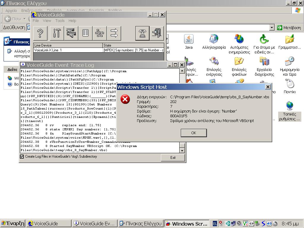

Script Error
I have a number like 1,75 in which the "," is decimal for Greece and we are using the Number comma as Decimal
When the program tries to say the number we take a VBScript error
We are aso sending the logs created
0120tw.txt
0120vgm.txt
Both trace and the screenshot show that the number supplied to be spoken has a decimal pint between the "1" and the "75", so you should use the normal "Say Number" function, not the function which expects a comma instead of the decimal point.
204858.02 8 rv replace start: [$rv[Products_5_1]]
204858.02 8 rv ns [PathSysVoice]{C:\Program Files\VoiceGuide\system\voice\}[PathApp]{C:\Program Files\VoiceGuide\}[PathDataVm]{C:\Program Files\VoiceGuide\data\}[PathVgSys]{C:\Program Files\VoiceGuide\system\}[DNIS]{22900}[scriptsPath]{C:\Program Files\VoiceGuide\Scripts\Transfer 1\}[scriptPath]{C:\Program Files\VoiceGuide\Scripts\Transfer 1}[$RV_STARTTIME]{20/1/2008 8:48:31 ìì}[$RV_DEVICEID]{8}[$RV_CIDNAME]{_______}[PathApp]{C:\Program Files\VoiceGuide\}[$RV_CIDNUMBER]{33}[$RV_DNIS]{22900}[DNIS]{22900}[select Query]{9}[Get Numbers 15]{80199}[Get Numbers 15_PathTaken]{success}[Products_RowCount]{1}[Products_1_1]{08012008}[Products_2_
]{08012009}[Products_3_1]{210}[Products_4_1]{195}[Products_5_1]{1.75}[Products_6
1]{}[suntirisi]{timeout}[Epomeni]{timeout}[Xreosi]{timeout}[Pistosi]{timeout}
204858.02 8 rv replace end: [1.75]
204858.03 8 state [MPEK] Say numbers: [1.75] as Number - comma as decimal
204858.03 8 fn PlaySoundStartNumbers [C:\Program Files\VoiceGuide\system\voice\MPEK.wav],[],[1.75],Number - comma as decimal
204858.05 8 sVbsFunctionToUse=Number_CommaAsDecimal
