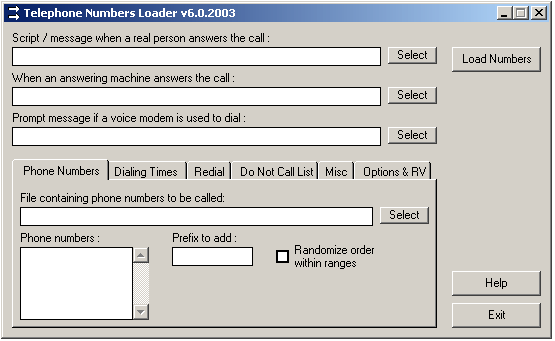

SupportTeam Report post Posted 03/25/2008 01:27 PM In v6 "Numbers Loader" the Answer Machine script/message setting is set in the second text line from the top. See the screenshot attached. Share this post Link to post
SupportTeam Report post Posted 03/25/2008 01:37 PM Using "disable" in the "Answering Machine Message" field allows turning off the call progress on per-call basis. The VG.INI approach would disable call progress detection for all outbound calls and transfers system-wide. Share this post Link to post
