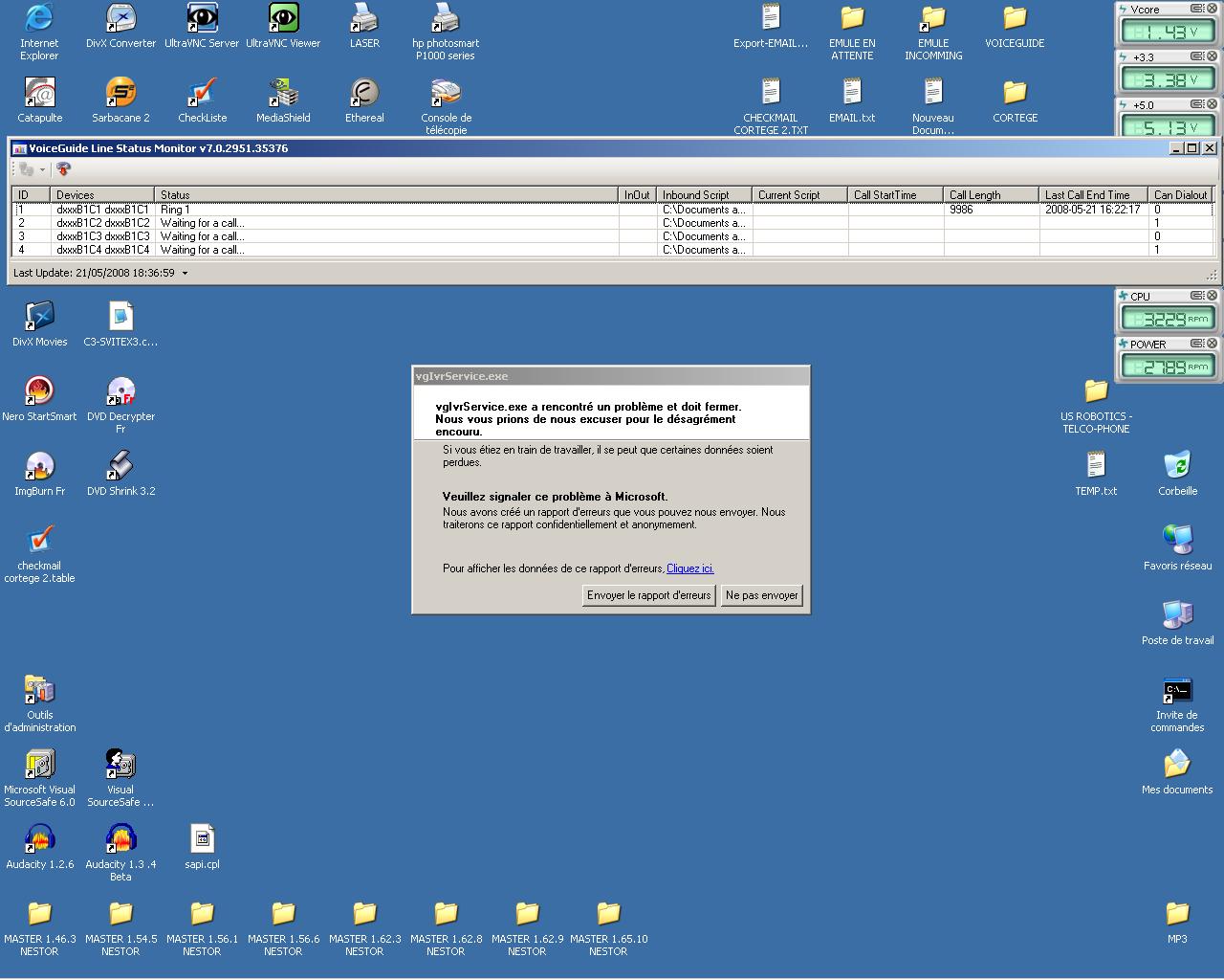

The second log finish here. The IvgService close itself with an error.

In the Vg log file at 18:36:11, just one ring and the error fire, and VGIVRService stop itself.
Always in the log file the random error is just after :
LsAwaitingCalls TDX_CST
And just before :
ev lev_CallerID [0488407050,,]
ecran.jpg is a screen shot for this error.

VERY URGENT Please...
I understand one thing.
Every time THIS number 04 94 20 04 89 call, voiceguide crash at the first ring. (Only This Number)
I 've tested this many times.
This morning i've received a call at 9:14 (04 66 79 05 23) it's okay.
I've received too a call from this number : (04 94 20 04 89) and Voiceguide crash at the first ring.
See the screenshots #1 in the zip file.
Every time this number call, voiceguide crash before the begining of the .VGS script.
See the full logs files in the zip.
Voiceguide received numerous calls with any problem but only with THIS number there is a big problem.

Very Urgent please :
I've installed the 7.0.6 and there is the same problem with another phone number.
At 9:25 - with the phone number 01 77 45 33 00 it works fine.
At 10:00 - with the phone number 04 93 78 02 02 voiceguide crash just before the startup script on the first Ring !
I understand the problem fire on some phones numbers.
I see every time the crash on every call of 04 94 20 04 89. (See previous post at 11:11 in version 7.0.4)

The error screenshot shows that the error occurred in the Microsdoft's DLL: MSVCR80.DLL at offset 000127da, and not in a VoiceGuide .EXE/or .DLL.
Searching for 000127DA on Google will show a few other reports of other people encountering such problems. Reading though some of those posts suggests that this is something related to video or sound card drivers.

I have copyed a new MSVCR80.DLL in system32 directory.
(Many users do this and the problems do not appear)
In my case, i've received many calls and it works fine.
But, i've received the call of the number 04 94 20 04 89.
EVERY TIMES, and SYSTEMATICALLY with THIS number VGIVRService crash and stop.
See the previous post #18 for problem description.
