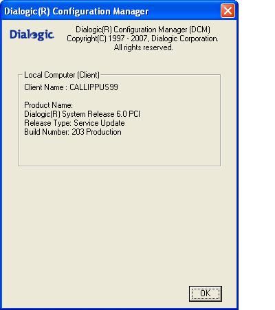

I am using Dialogic D/4PCIU with voiceGuide. with single line (Airtel wireline in India)
The issue is I have to detect the disconnected tone and exit my script if it already running and send a busy/disconnected tone over the line.
For this i did the following:
I used Dialogic's PBXpert tool to create the tone file which defines what disconnect/busy tones are played by your telephone company or PBX when the call is finished, and then tell Dialogic Configuration Manager to load your 'tone file' by specifying in the DCM:
Then I set the following in the DCM
TSFFileSupport=Yes
DisconnectTone=Yes
TSFFileName=your .tsf file.
Please suggest me a proper way for handling this.
But even after doing this my script does not stop running and hang up the call.

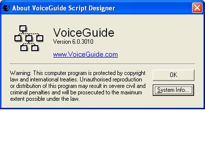

I am using Voice guide 6.0.3010
The traces you have been posting are from v7:
165646.171 6088 ------------------------------------------------------------------------------
165646.171 6088 ktTel_SR60 DLL v7.0.7, created: Sep 26 2008, 17:15:31
165646.171 6088 start at 1022 165646.171
The script editor that ships with v7 is still (for now) the same one as used in v6, and script editor is labelled as v6, but you are actually using VoiceGuide v7

Go to:
Start -> Programs -> Intel/Dialogic System Release - > Configuration Manager - DCM
then from Help menu click About.
Please post screenshot of what you see.
Looks like you are using SR6.0 SU203. That should be fine. Strictly speaking the version of drivers that should be used is the one that is specified next to the VoiceGuide v7 download link, but a later version then that is usually OK.
