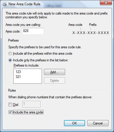

See attached screenshot of Windows' Area Code Rules that help with this issue when using the PC's modem. You basically instruct the modem how it should dial numbers with the included prefixes.
We may add a "Dialing Rules" tab to the Telephone Number Loader application.
At this stage it looks like using the following rule template should cover all of requirements that people who use this page may have.
The proposed rule template a this stage is:
For numbers starting with "%prefix%" trim %X% leading digits and then add prefix "%addthis%"
eg a set of rules could be:
For numbers starting with "828" trim 3 leading digits and then add prefix ""
For numbers starting with "828123" trim 0 leading digits and then add prefix ""
With the longest prefix match taking precedence.
eg. if above two rules were used the number 8285551111 would be dialed as 5551111, and number 8281234444 would be dialed as 8281234444. The "Prefix to add" setting specified on the "Phone Numbers" page is ignored and the "%addthis% prefix setting from the matching rule is used.
