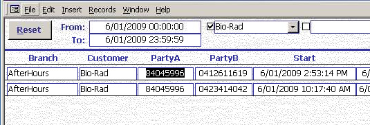

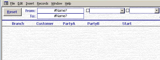

Guest miva Report post Posted 01/06/2009 03:37 AM SMTP Issue: Connectivity didn't appear to be the problem as the emails worked before we upgraded to the new version and again after we rolled back to the previous version. Emails only stopped working temporarily while we tested the new version of software for a period of about 10 mins. We've installed WireShark and will run further tests after hours and post any relevant traces then. Database Issues: Connectivity to the database worked but the new version seemed to cause other problems for administering our database. Strange issues. We have an MS Access form that displays filtered information from a table (showing call stats between dates/times), when we installed the new version of VG and opened this form all the dates were displaying incorrectly saying that calls that had occured on the 5th had datestamps for the 4th. When we rolled the software back the dates showed up correctly again. Additionally, two default fields on the form in Access were showing an error until we rolled the software back. Regards, Ben. Share this post Link to post
SupportTeam Report post Posted 01/06/2009 04:11 AM all the dates were displaying incorrectly saying that calls that had occured on the 5th had datestamps for the 4th. I assume that you are referring to data inserted using a Database Query module from the script? The full SQL insert statements are listed in the log, and these show what VoiceGuide inserted etc. into the database in any of the Database modules and CDR saves etc. In the traces provided there is no instance of any dates from the 4th being inserted. All dates are from the 5th. Not sure if the database your are using has an SQL log of it's own, but it if does not then you may be able to further track the various SQL insertions by creating some sort of a unique tag and including that tag in one of the inserted fields, that approach is just one way of tracking what SQL statement created which database entry. Share this post Link to post
Guest miva Report post Posted 01/06/2009 04:22 AM Well that's what I meant by strange. The SQL insert worked fine. The data in the table is fine. But when we install the new version of VG on the server the data displays incorrectly. When we uninstall it, the data displays correctly again. I'll organise some screen shots (before and after) for you tonight and show you what I mean. I don't believe it's an SQL problem. Regards, Ben. Share this post Link to post
SupportTeam Report post Posted 01/06/2009 07:00 AM If the data is inserted into the table correctly by VoiceGuide then not sure how else VoiceGuide could be affecting this other application. Share this post Link to post
Guest miva Report post Posted 01/06/2009 10:44 PM We have conducted further testing and found the following: With the new version of VG supplied we are currently unable to access the Script Designer either via the shortcut on the IVR Monitor or through the program link found under the start button. The problem associated with our database appears to be formatting related. I've attached two screen shots, before and after the install to show you what I mean. I suspect that some date formating may be changed during the installation. As soon as we uninstall the dates load correctly. We can manually type them back in and it works, so its not a major issue but obviously something is being changed. The main issue is the script designer, any suggestions, can you replicate this problem? Share this post Link to post

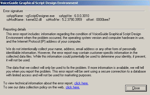

Guest miva Report post Posted 01/08/2009 10:46 PM Just a bit more information that might assist you in diagnosing the problem. When we restarted the Server yesterday we got the following error message on startup. Share this post Link to post
SupportTeam Report post Posted 01/08/2009 11:32 PM This report shows that error occurred in Windows' kernel32.dll when trying to run the Script Designer. Which version of Windows is used on this system? Do you have all the latest Updates and Service Packs installed on it as well? Is anything else installed on this system, or just Windows+Dialogic+VoiceGuide ? Share this post Link to post
