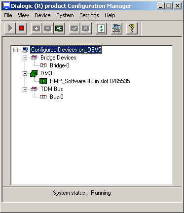

dminof Report post Posted 02/11/2009 04:02 PM Hello, I am interested in purchasing VoiceGuide version 7 using VoIP. I followed all the steps for installation. Install 1. NET 2.0 and. NET 3.0 2 installed HMP 3.0 (SU225) In Dialogic HMP does not exist in any configuration. We need to configure anything here? As I make it? I attach the images 3 Set up the license. (4 port evaluation license) 4 install VoiceGuide 7 and select the "VoIP / HMP 5 in Config.xml set to asterisk. <? xml version = "1.0"?> <VoiceGuideConfig> <Devices_Dialogic> <Channels> <channel> <Device_Voice> DxxxB1C1 </ Device_Voice> <Device_Network> IptB1T1 </ Device_Network> <Device_Media> IpmB1C1 </ Device_Media> <protocol> IP </ Protocol> <script> D: \ Program Files \ VoiceGuide1 \ Scripts \ Credit Card Payment \ Credit Card Payment.vgs </ script> <AllowDialOut> 1 </ AllowDialOut> </ Channel> <channel> <Device_Voice> DxxxB1C2 </ Device_Voice> <Device_Network> IptB1T2 </ Device_Network> <Device_Media> IpmB1C2 </ Device_Media> <protocol> IP </ Protocol> <script> D: \ Program Files \ VoiceGuide1 \ Scripts \ Credit Card Payment \ Credit Card Payment.vgs </ script> <AllowDialOut> 1 </ AllowDialOut> </ Channel> <channel> <Device_Voice> DxxxB1C3 </ Device_Voice> <Device_Network> IptB1T3 </ Device_Network> <Device_Media> IpmB1C3 </ Device_Media> <protocol> IP </ Protocol> <script> D: \ Program Files \ VoiceGuide1 \ Scripts \ Credit Card Payment \ Credit Card Payment.vgs </ script> <AllowDialOut> 1 </ AllowDialOut> </ Channel> <channel> <Device_Voice> DxxxB1C4 </ Device_Voice> <Device_Network> IptB1T4 </ Device_Network> <Device_Media> IpmB1C4 </ Device_Media> <protocol> IP </ Protocol> <script> D: \ Program Files \ VoiceGuide1 \ Scripts \ Credit Card Payment \ Credit Card Payment.vgs </ script> <AllowDialOut> 1 </ AllowDialOut> </ Channel> </ Channels> <Parms> </ Parms> </ Devices_Dialogic> <VoIP_Lines> <VoIP_Registrations> <VoIP_Registration> <display> Asterisk_DEV6_3000 </ Display> <protocol> SIP </ Protocol> <RegServer> 192.168.1.79 </ RegServer> <RegClient> 3000@192.168.1.79 </ RegClient> <LocalAlias> Sip: 3000@192.168.1.79: 5060 </ LocalAlias> </ VoIP_Registration> </ VoIP_Registrations> <VoIP_Authentications> <VoIP_Authentication> <display> Asterisk_DEV6_3000 </ Display> <Domain> Asterisk </ Domain> <username> </ Username> <AuthUsername> 3000 </ AuthUsername> <AuthPassword> 1234 </ AuthPassword> </ VoIP_Authentications> </ VoIP_Lines> </ VoiceGuideConfig> B,R , thank you for your help Diego Miño Telalca Mis_im_genes.zip Share this post Link to post
SupportTeam Report post Posted 02/11/2009 11:50 PM The DCM Screenshot shows that HMP is not installed properly. You should see the DM3 class and the HMP_Software device underneath that. Like this: Share this post Link to post
dminof Report post Posted 02/13/2009 09:34 PM Hello, already installed Dialogic HMP. Not if I have to configure anything in HMP. Config.xml is configured to work with asterisk. Please your help B,R Diego Miño Config.zip Share this post Link to post
SupportTeam Report post Posted 02/14/2009 05:49 AM Looks like HMP is properly configured now. Can you please now .ZIP up and post the vgEngine and ktTel traces showing VoiceGuide startup. Share this post Link to post
