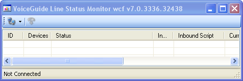

090309 seems to have been working all day. Then just in the last hour, the service monitor shows an X. When I try to start it I get "Not Connected".
I exited the service monitor and started a new one with the same results.
I've attached a screen shot and log files.
Please advise.

It just started again OK. I'm not sure why it is flaking out like this. Now it shows the 4 lines as OK.
If the IVR Service Monitor in the Icon Tray shows a red X then this means the IVR service is not running.
Restarting the service monitor will not start the service itself. To start the service you need to either right click on the service monitor and select Start from the popup menu or start the service from the Windows Service Manager.
If the IVR service is not started then the Line Status app will show "Not Connected".
Right now the line status shows "Not Connected" but the service monitor shows that the service is running. I've stopped and restarted several times. I noticed this after a reboot.
When I call in, VG is working fine, like the service is running on the right script, just the line status is hosed.
