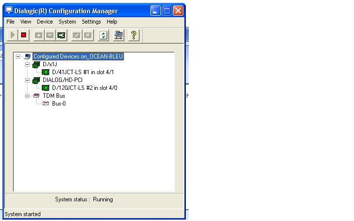

mehdi_h Report post Posted 04/22/2009 10:17 PM Hi team, here is the requested logs. I have set the grey switch to "1" for the D/41JCT and "2" for the D/120JCT but on the DCM it seems that the order is not this one. So in that configuration could you please tel me how the config.xml should look like. Thank you for your help Mh 0423_ktTel.zip Share this post Link to post

mehdi_h Report post Posted 04/22/2009 10:53 PM Well, Please consider this post. Now I have set the D/120JCT to the first position and the D/41JCT to the second. When making incoming call I have two lines rigining at the same time Please find below the logs and the DCM screen shot. I would be happy to solve that. Thank Mh log.zip Share this post Link to post

SupportTeam Report post Posted 04/23/2009 01:14 AM ktTel trace shows: 011825.390 4044 dxxxB1C1 id=0x6001, family=2, devmode=0, network=3(Analog), bus=6, encode=0 011825.421 4044 dxxxB2C1 id=0x4403, family=3, devmode=0, network=3(Analog), bus=6, encode=0 011825.437 4044 dxxxB3C1 id=0x4403, family=3, devmode=0, network=3(Analog), bus=6, encode=0 011825.484 4044 dxxxB4C1 id=0x4403, family=3, devmode=0, network=3(Analog), bus=6, encode=0 So looks like dxxxB1 is on the D/41JCT and the dxxxB2, dxxxB3, dxxxB4 are on the D/120JCT. So to open the first 8 ports on the D/120JCT the <Channels> section of the Config.xml should look like this: <Channel> <Name>dxxxB2C1</Name> <NetworkIf>dxxxB2C1</NetworkIf> <Protocol>pdk_na_an_io</Protocol> <RingsBeforeAnswer>0</RingsBeforeAnswer> <script>C:\Program Files\VoiceGuide\Scripts\gmail2.vgs</Script> <AllowDialOut>1</AllowDialOut> </Channel> <Channel> <Name>dxxxB2C2</Name> <NetworkIf>dxxxB2C2</NetworkIf> <Protocol>pdk_na_an_io</Protocol> <RingsBeforeAnswer>100</RingsBeforeAnswer> <script>C:\Program Files\VoiceGuide\Scripts\gmail2.vgs</Script> <AllowDialOut>1</AllowDialOut> </Channel> <Channel> <Name>dxxxB2C3</Name> <NetworkIf>dxxxB2C3</NetworkIf> <Protocol>pdk_na_an_io</Protocol> <RingsBeforeAnswer>0</RingsBeforeAnswer> <script>C:\Program Files\VoiceGuide\Scripts\gmail2.vgs</Script> <AllowDialOut>1</AllowDialOut> </Channel> <Channel> <Name>dxxxB2C4</Name> <NetworkIf>dxxxB2C4</NetworkIf> <Protocol>pdk_na_an_io</Protocol> <RingsBeforeAnswer>0</RingsBeforeAnswer> <script>C:\Program Files\VoiceGuide\Scripts\gmail2.vgs</Script> <AllowDialOut>1</AllowDialOut> </Channel> <Channel> <Name>dxxxB3C1</Name> <NetworkIf>dxxxB3C1</NetworkIf> <Protocol>pdk_na_an_io</Protocol> <RingsBeforeAnswer>0</RingsBeforeAnswer> <script>C:\Program Files\VoiceGuide\Scripts\gmail2.vgs</Script> <AllowDialOut>1</AllowDialOut> </Channel> <Channel> <Name>dxxxB3C2</Name> <NetworkIf>dxxxB3C2</NetworkIf> <Protocol>pdk_na_an_io</Protocol> <RingsBeforeAnswer>0</RingsBeforeAnswer> <script>C:\Program Files\VoiceGuide\Scripts\gmail2.vgs</Script> <AllowDialOut>1</AllowDialOut> </Channel> <Channel> <Name>dxxxB3C3</Name> <NetworkIf>dxxxB3C3</NetworkIf> <Protocol>pdk_na_an_io</Protocol> <RingsBeforeAnswer>0</RingsBeforeAnswer> <script>C:\Program Files\VoiceGuide\Scripts\gmail2.vgs</Script> <AllowDialOut>1</AllowDialOut> </Channel> <Channel> <Name>dxxxB3C4</Name> <NetworkIf>dxxxB3C4</NetworkIf> <Protocol>pdk_na_an_io</Protocol> <RingsBeforeAnswer>0</RingsBeforeAnswer> <script>C:\Program Files\VoiceGuide\Scripts\gmail2.vgs</Script> <AllowDialOut>1</AllowDialOut> </Channel> Share this post Link to post

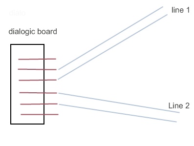

mehdi_h Report post Posted 04/23/2009 08:55 AM hi, Thank you, does it explain somehow the outgoing calls are not set anymore ? Here is the way I have wired the bords in attachement it is correct? is there any polarisation (+ / -) ? Thank you Mh Share this post Link to post
SupportTeam Report post Posted 04/23/2009 10:29 AM The wiring is not right. The two wires of line 1 go to the two pins in the center (pins 3 and 4) The two wires of line 2 go to the two pins on the either side of line 1's pins (ie. to pins 2 and 5) (and on DMV160 the line 3 goes to the two outside pins (pins 1 and 6)) There is no polarization on analog telephone lines. This is all explained in the D/120JCT installation pamphlet that should have come with the card. Share this post Link to post
