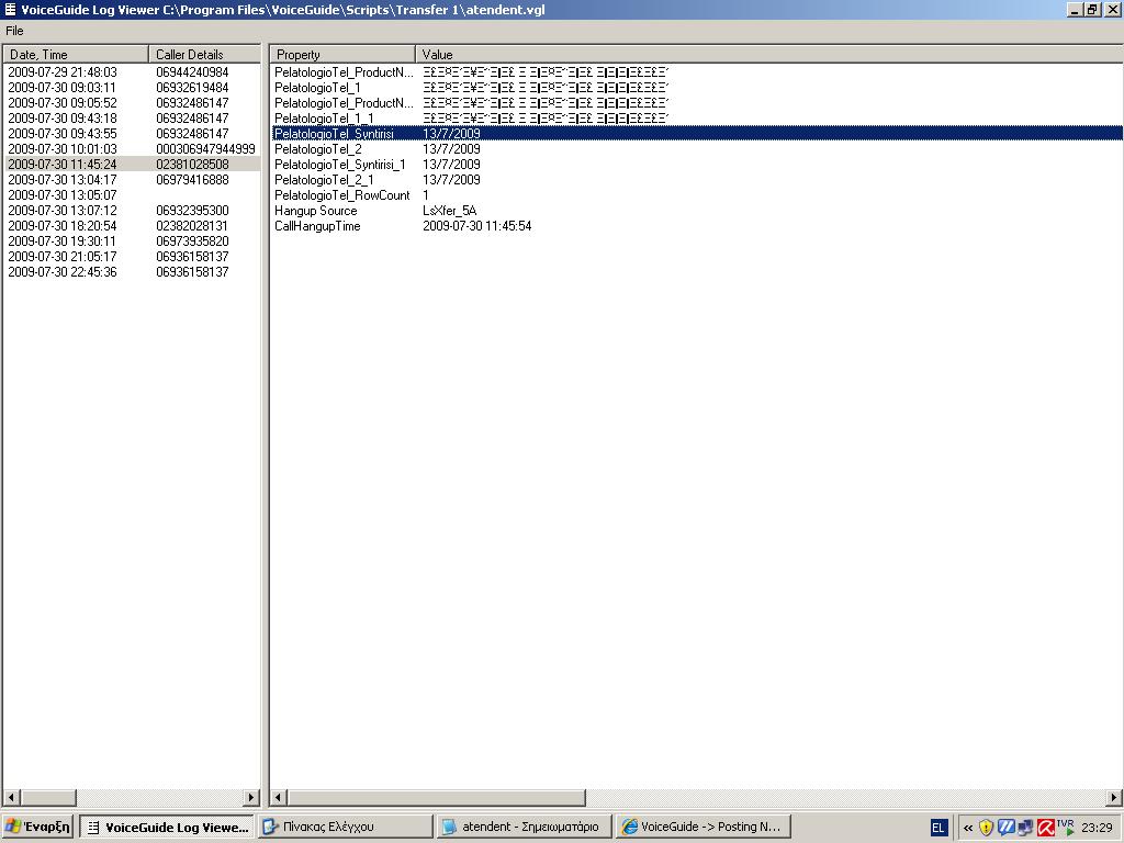

Is it possible to view Greek in the VoiceGuide Log Viewer?
Everything in Greek is displayed with wrong characters
I also notice that the same characters are written to the log file
I'm sending you an image of the window
Which version of VoiceGuide are you using?
Could you please post a copy of VoiceGuide's Debug Trace Printout which captures a call, this will allow us to see what is happening during the call.
From traces it looks like the Greek characters are imported into VoiceGuide when VoiceGuide does a database query.
Can you .ZIP up and post a sample of the MSAccess Products.mdb that you are retrieving this data from?
We could then have a better look at this.
Are you running a Greek version of WinXP?
