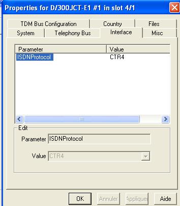

mehdi_h Report post Posted 02/09/2010 08:10 PM Hi Support team, Finally I have installed the D/300 JCT board and did what you have advised to me . I have set the protocol to CTR4 and started eveything but I can't to any calls for now. The light on the D/300 JCT-E1 board is red. Please find in attachement the logs that I have just generated right now. Thank you for your help. Mh log.zip Share this post Link to post
SupportTeam Report post Posted 02/09/2010 09:42 PM The light on the D/300 JCT-E1 board is red. If the light on the D/300JCT-E1 board is red then this means that the cable that is plugged into it is not carrying any E1 signaling. Suggest you confirm that that E1 trunk is enabled and then check the cabling itself. Use loopback connectors and loopback test modes on PBX/Switch to check cabling. Share this post Link to post
