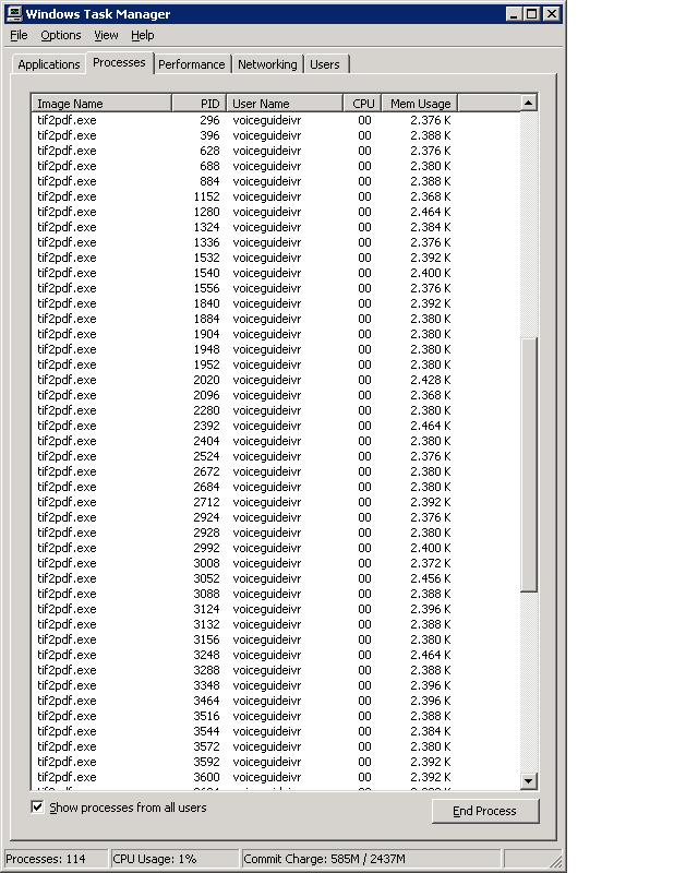

Yesterday we had problems again. We notice, when the problem was occurring, there was a backlog of process 'tif2pdf.exe' running. (attached the situation).
Do you thing it can be related with the problem ?
We are planning to install the VG version 7.0.3615.29861 in the first server. Do you thing it can solve the problem ?
