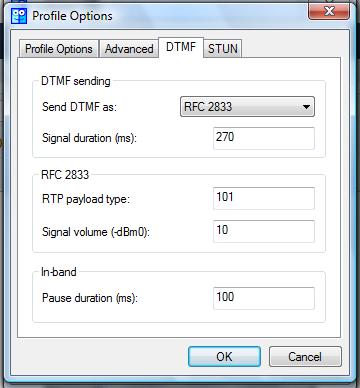

mehdi_h Report post Posted 01/20/2010 08:26 PM Well this has been setup by default with following values. Are they correct ? dtmf sending: RFC 2833 signal duration = 270ms RFC payloadtype= 101 signal volume = 10 Indand: duration = 100ms tkx Share this post Link to post
mehdi_h Report post Posted 01/20/2010 09:12 PM Hi, The RFC 2833 is setup by default. here are the settings. are they correct? Share this post Link to post
