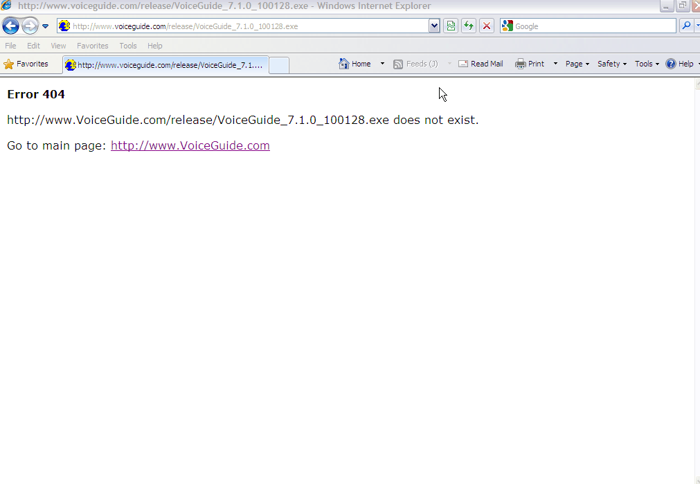

When I first downloaded the exe file, VG would not start so i uninstalled and reinstalled Dialogic and VG but then even Dialogic would not stsrt so I decided to start from scratch and reinstall Windows, Dialogic and VG. But now I cannot download the exe at all. (See attached screenshot).
Can you help please?
