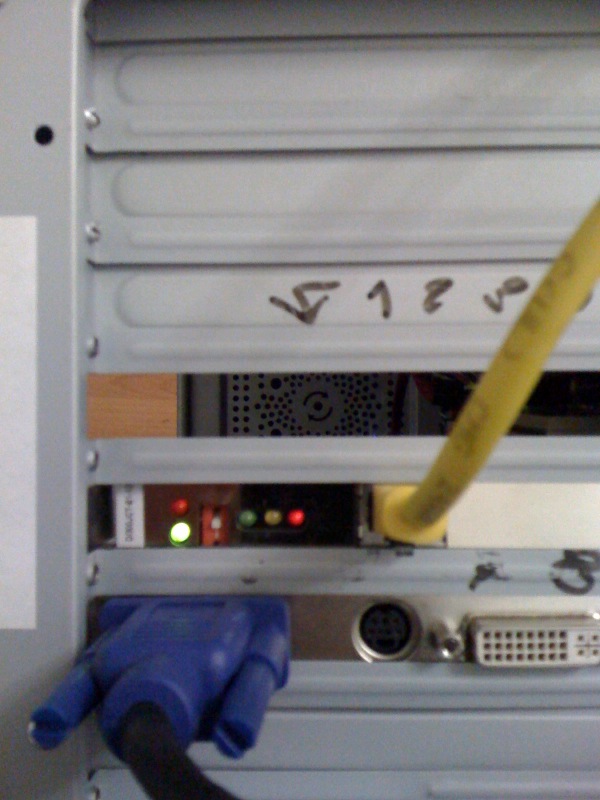

SupportTeam Report post Posted 02/09/2010 10:28 PM I have attached a foto with the baors lights. The photo of the board's lights was not attached. Please post is again. Share this post Link to post
mehdi_h Report post Posted 02/09/2010 10:39 PM Here is the foto, but I tought I have started another post .. I have now only the D/300JCT on the server to make make things simple. Do you need me to do anything to test something ? tkx Mh Share this post Link to post
SupportTeam Report post Posted 02/09/2010 10:56 PM The back of the card looks a bit strange. Is it a D/300JCT PCI card? It has a few more LEDs then a D/300JCT. Photo shows the big green LED on the left as ON, but it is hard to make out if any of the three LEDs on right are ON... How to the LEDs change when you pull out and insert the E1 cable? What results do you get when testing the E1 card with ISDIAG? (Please see: http://www.voiceguide.com/vghelp/source/html/configisdnsetup.htm ) Do you have a CT-Bus cable? (We moved your posts into one thread. Please keep related posts in same thread) Share this post Link to post
mehdi_h Report post Posted 02/09/2010 11:21 PM I have restarted and now they are clearly 2 leds ON: - The green on the left is ON - The red on the right(the last one) is ON. Do you think this coude have something to do with dialogic drivers, i'm not sure I have installed the IDSN pack. How can I check that ? tkx PS: I dont have any CTBus because I have only one board now D/300JCT-E1-120 Share this post Link to post

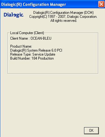

SupportTeam Report post Posted 02/10/2010 03:08 AM Which version of Dialogic drivers is installed on this system? (See Help->About in the Dialogic DCM) Do the LEDs on the left change at all when you disconnect and reconnect the E1 cable? Share this post Link to post

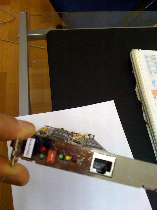

SupportTeam Report post Posted 02/10/2010 03:11 AM What is the 8 character Serial Number of the D/300JCT card? Can you take a close up high resolution photo of the card itself and of the back of the card (the part that is visible outside computer) and post the photos here please (.ZIPed). Share this post Link to post
mehdi_h Report post Posted 02/10/2010 09:44 AM "Which version of Dialogic drivers is installed on this system? (See Help->About in the Dialogic DCM)" >> 6.0 "Do the LEDs on the left change at all when you disconnect and reconnect the E1 cable?" >> Actually there is not effect on the leds when plugin and unpluging the cable. >> When starting DCM the red red lignt (on the right) is ON when stopping serive the red lignt is OFF I'do doing a better foto, but in the meantime,the DCM show D/300JCT-E1 Do you want me to do a loopback test? how can I do that and how do I have to connect the board (never done this yet) Thank you Mh Share this post Link to post
SupportTeam Report post Posted 02/10/2010 10:11 AM "Which version of Dialogic drivers is installed on this system? (See Help->About in the Dialogic DCM)">> 6.0 Which Service Update (SU) version? >> Actually there is not effect on the leds when plugin and unpluging the cable. This suggests that either there is no signal on the E1 cable, or the card is faulty. Do you want me to do a loopback test? how can I do that and how do I have to connect the board (never done this yet) You would need to connect the Tx wire pair back to the Rx wire pair. This should give you green LED on the card. Use an RJ45 plug and have the Tx and Rx wire pairs looping back to each other. Please post more photos of this card. This card does not look like a current model D/300JCT. Share this post Link to post
mehdi_h Report post Posted 02/10/2010 11:39 AM Serial number on the card: FX000394 on DCM the boarded detected is a D/300 JCT tkx Share this post Link to post
mehdi_h Report post Posted 02/10/2010 02:06 PM In the meantime I have asked the board resselers about it, here is his anwser: "This board is the D/300JCT-E1-120. This board has a PCI connection which is why is only has one notch. There is another board with part number D/300JCT-E1-R2U-120. This part number has two notches which makes it a PCI-X connection. " Hope this will help Mh Share this post Link to post
