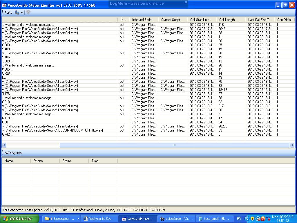

mehdi_h Report post Posted 03/22/2010 05:53 PM Here is a screen shot of what happens today. Logs attached. Thank you Mh Share this post Link to post
SupportTeam Report post Posted 03/23/2010 08:29 PM Could you please .ZIP up and post traces which cover the time from 1pm till 7pm on 22nd March. Share this post Link to post

SupportTeam Report post Posted 04/01/2010 11:23 AM Looks like the 3 lines stopped making outgoing calls as there was a problem with sound file playback. The other lines do not seem to be affected in any way, and the result is that the number of ports making outbound calls is reduced. This is a different issue then the one found in traces earlier on. Can you .ZIP up and post the ktTel file for the 03-22 day? Which Dialogic cards and Dialogic drivers are used on this system? 134235.734 19 32 17 ev Dialogic 135,TDX_SETHOOK, crn=200064c2, 0,0,0,DX_OFFHOOK,CALL_OUTBOUND, 134235.734 19 32 17 qScr add evScriptEvent 135 TDX_SETHOOK 134235.734 6 32 17 qScr run evScriptEvent sCode=[TDX_SETHOOK] iActionID=0, crn=200064c2[0|0|0|0|0][DX_OFFHOOK|CALL_OUTBOUND||||] 134235.734 6 32 17 scriptevent TDX_SETHOOK param1:DX_OFFHOOK, param2:CALL_OUTBOUND, param3: 134235.734 6 32 17 LsWaitAfterDialingOut : 135,200064c2,TDX_SETHOOK,0,0,0,DX_OFFHOOK,CALL_OUTBOUND, 134242.734 19 32 17 ev CallState TDX_CALLP_CR_CNCT, crn=200064c2, iEvent=2 ,256,2,4,,,]. vgEngine v7.1.3722.40345 (2010-03-11 22:24:51.71) 134242.734 19 32 17 qScr add evCallState 2 TDX_CALLP_CR_CNCT 134242.734 19 32 17 ev Dialogic 133,TDX_CALLP, crn=200064c2, 10,3,0,CR_CNCT,CON_PVD, 134242.734 19 32 17 qScr add evScriptEvent 133 CON_PVD 134242.734 6 32 17 qScr run evCallState sCode=[TDX_CALLP_CR_CNCT] iActionID=0, crn=200064c2[256|2|4|0|0][|||||] 134242.734 19 32 17 qScr add evScriptEvent 133 TDX_CALLP 134242.734 6 32 17 LineEvCallState eLineStateThisEvent=Connected 134242.734 19 32 17 ev Dialogic 134,TDX_CST, crn=200064c2, 1137,0,0,DE_LCON,, 134242.734 6 32 17 LineEvCallState ScriptState=LS_WAITAFTERDIALINGOUT 134242.734 19 32 17 qScr add evScriptEvent 134 TDX_CST 134242.734 6 32 17 ls set Connected (scriptstate=LS_WAITAFTERDIALINGOUT) 134242.734 6 32 17 yLineStateAppPov: Connected crn=200064c2,ev=2,TDX_CALLP_CR_CNCT,2, sParam1= 134242.734 6 32 17 LineEvCallState LINECALLSTATE_CONNECTED begin 134242.734 6 32 17 Set_hCall crn=200064c2, called from LINECALLSTATE_CONNECTED 134242.734 6 32 17 LineEvCallState_Connected_OutBound crn=200064c2, WorkingModeScript=Running_Dialing 134242.734 6 32 17 CDRCallOutcomeSet setting IvrDevState dateThisCallAnswerTime 134242.734 6 32 17 rvns add [OutDial_Result]{ANSWERED} 134242.734 6 32 17 ScriptWorkingMode set Running_Normal, (called from LineEvCallState_Connected_OutBound) 134242.734 6 32 17 dial wait as LineState().sCallProgressOption=[DX_PAMDOPTEN] 134242.734 6 32 17 state Dialing 00466395287..., doing answer detection... (DX_PAMDOPTEN) 134242.734 6 32 17 state [M1] Playing wav (C:\Program Files\VoiceGuide\Sound\TeamCell.wav) 134242.734 6 32 17 t timer clear (force=False) 134242.734 6 32 17 qTel add cmd_PlayStart [0,0,0,0,0][||||] 134242.734 6 32 17 play start ok, playId=996453 134242.734 7 32 17 qTel run cmd_PlayStart 134242.734 6 32 17 qScr run evScriptEvent sCode=[TDX_CST] iActionID=0, crn=200064c2[1137|0|0|0|0][DE_LCON|||||] 134242.734 6 32 17 scriptevent TDX_CST param1:DE_LCON, param2:, param3: 134242.734 6 32 17 LsPlayMsg EV_UNKNOWN_134,TDX_CST 134242.734 6 32 17 path {TDX_CST} not found Share this post Link to post
mehdi_h Report post Posted 04/01/2010 02:32 PM No this is always the same probleme.Actually the problem occurs often and with diffrent line. I have to stop VG and restard again to fix it.What could be the issue with the wav file, as I'm usgin exactly the same file for all line ?I'm using the last dialogic driver that I have downloaded from your site "Dialogic_drivers_for_VoiceGuide_v7.1_XP_2003".Here is the requested attachement.[old link removed]Tkx Share this post Link to post
