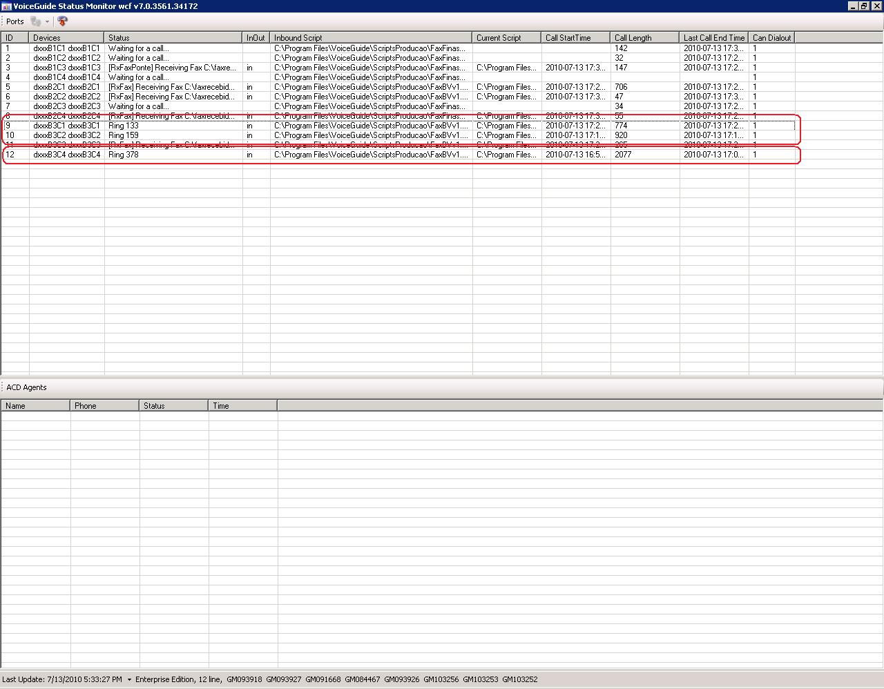

clauschmidt Report post Posted 07/13/2010 08:48 PM Thanks for the response. The problem that the server was stoped after a call was fixed. It was occuring only in the new server. After install the version 7.1 it was fixed. Now the problem is that the line stay blocked after some calls. It shows "Ring 1", "Ring 2", etc. Attached there is an image showing this. In this server I configured the line as you said in http://voiceguide.com/forums/index.php?showtopic=6302&view=&hl=tif2pdf&fromsearch=1 ---------- <Tone Name="FAX Incoming"> <Notes>Incoming fax tone</Notes> <ID>FAX</ID> <Freq1>1100</Freq1> <Freq1Dev>50</Freq1Dev> <Freq2>0</Freq2> <Freq2Dev>0</Freq2Dev> <On>50</On> <OnDev>10</OnDev> <Off>250</Off> <OffDev>60</OffDev> <Count>3</Count> </Tone> ---------- What can be happening? log1.zip log2.zip log3.zip log4.zip log5.zip Share this post Link to post
