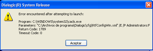

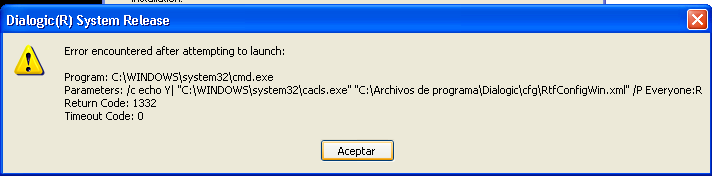

we donwload from your website the software Dialogic_drivers_for_VoiceGuide_v7.1_XP_2k_2k3_250.zip to test the PCI card D4PCIUFW (881-775) bought , but after instal the exe. and reboot the computer we obteined the errors shown in the files attached.
In this point we would like to know the correect drivers version compatible with Windows XP under Windows Server 2003 R2.
Did you install the software while logged in as Administrator?
Which options did you select when installing the drivers? (Best to just tick all of them).
