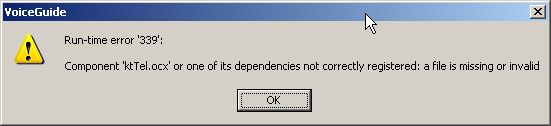

Run Time Error 339
after installation VG showing this window
both configurations:
VG 6.0.3391, Dialogic D/300PCI-E1
VG 6.0.3391, DIALOGIC D/120JCT-LS
This usually means that the Dialogic drivers are not installed on the system.
Which version of Dialogic drivers is installed on the system? Have you ran the Dialogic demo apps to test that the cards are answering calls ?
Are the D/300PCI-E1 and D/120JCT-LS in same system?
No, I try to configure two servers one with D/300 (VG 6) second with D/120 (VG 7.1.)
Don't think that SR6.0 drivers support D/300PCI, so you would need to use SR5.1.1 FP1 drivers and VG v6 for that card.
(try SR6.0 drivers and see if they detect D/300PCI card).
D/120JCT can be used with SR6.0 drivers, and hence with VG v7.
