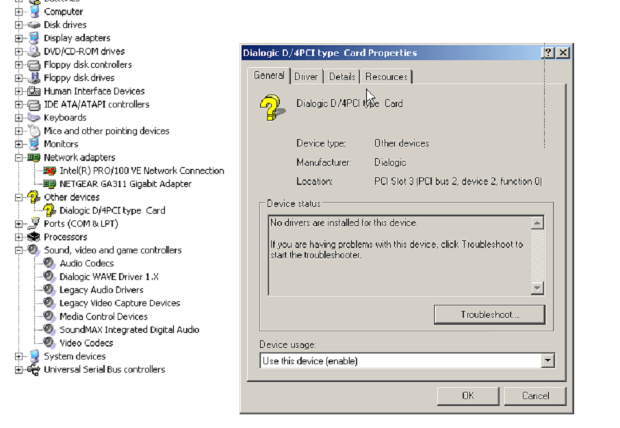

In Device Manager, I show a "Dialogic D/4PCI type Card" under "Other Devices". It shows that no driver is installed for it. Where can I find the driver I need for this, or is this how it is supposed to be? (see attached pic)

When I review the Device Manager, it shows a "Dialogic D/4PCI type Card" that has no drivers installed for it. Where can I get these drivers, or is this the way it is supposed to be? (see attached pic)
I'm trying to avoid reinstalling VG so I don't lose the config.

The Dialogic TAPI/WAVE drivers have been discontinued for a long time now.
The Dialogic TAPI/WAVE drivers may still be available for download as part of the SR5.x drivers download from Dialogic.
See: http://www.dialogic.com/products/tdm_boards/system_release_software/download/dialogic/win/5.1.1-fp-1-su-149.htm
If you are using a Dialogic card then you also have the option of upgrading system to v6 or v7 of VoiceGuide.
