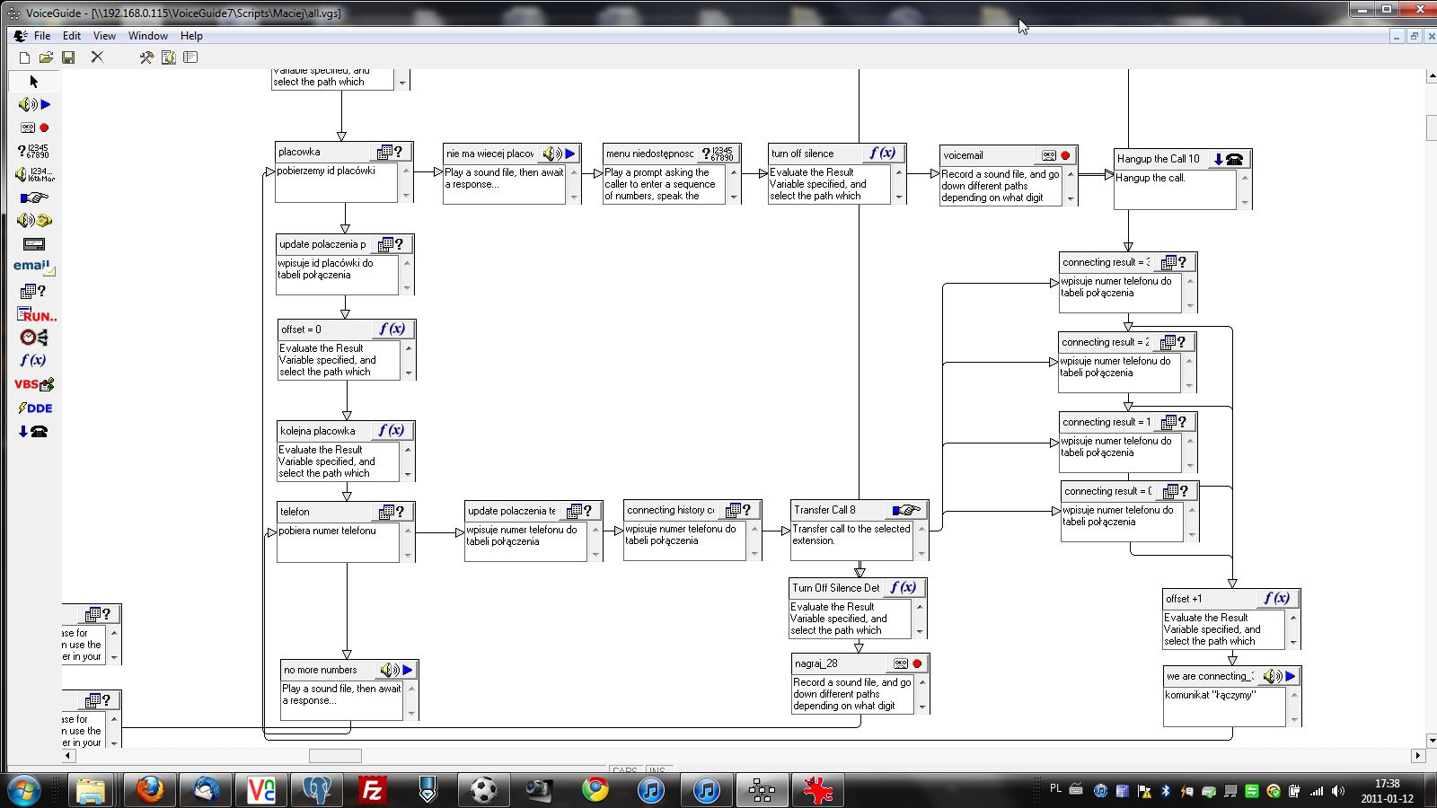

invoso.com Report post Posted 01/12/2011 11:25 AM I want to join two TOPICS: "Detecting Busy On Pri Isdn Dialogic D/600" and "Announced Call No Demand". Attachment includes logs of two connections. 1st connection - transfered to number 566453826 with announcement (in transfer module active was "Dialout and Conference - Monitored" option and no "Announced" checked) 2nd connection - target phone number was busy and VG hangup connection Paths in transfer module look: on {answer} goto [Turn Off Silence Detection call] on {success} goto [Turn Off Silence Detection call] on {BUSY} goto [connecting result = 1] on {fail} goto [connecting result = 3] on {timeout 20} goto [connecting result = 2] I expected that connection will forwarded to next element of script - {BUSY} or {fail} way. sisti logs.zip Share this post Link to post

invoso.com Report post Posted 01/12/2011 04:57 PM OK i found that VG trying to connect and detect that target line is busy but still I can't breaking script to go forward. VG writing data in "connecting result - ..." module, next to "offset + 1" and in log file i see that VG should to play "komunikaty\50003.wav" file but it doesn't working. 173104.328 6 2 1 PrepareAndPlayWavAndTts start iModuleIdx=70, iPlayFileIdx=1, bMakeTtsFile=True, sSoundFileIs= 173104.328 6 2 1 PrepareAndPlayWavAndTTS sPlayFile=komunikaty\50003.wav 173104.328 6 2 1 state [we are connecting_35] Playing wav (komunikaty\50003.wav) Call is terminated but should to use next module: "telefon" and go to "Transfer Call 8" and try to connect with next phone number. 0112_1730_vgEngine.zip Share this post Link to post
SupportTeam Report post Posted 01/12/2011 07:20 PM When 2nd leg of call is disconnected your script is in module [we are connecting_35] That module does not have the path OTHER_LEG_Disconnected specified, so the system hangs up orignal leg of the 'dial and conference' call. You should add path on {OTHER_LEG_Disconnected} goto [telefon] in module [we are connecting_35] 173104.156 6 2 1 qScr run evScriptEvent sCode=[OTHER_LEG_Dialing] iActionID=0, crn=0[16|0|16|0|0][|||||] 173104.156 6 2 1 scriptevent OTHER_LEG_Dialing 16|0|16 || 173104.171 6 2 1 LsXfer_7_dc_WaitOutcomeOutgoingCall_InLeg : [OTHER_LEG_Dialing], 0(EV_UNKNOWN_0),16,0,16,,,), xferType=32, leg2=88 173104.171 6 2 1 x7_dc_in before XFER_ANN_ACCEPTED test. sCode=OTHER_LEG_Dialing 173104.171 6 2 1 path {OTHER_LEG_Dialing} found (at offset 349) 173104.328 6 2 1 state [we are connecting_35] Playing wav (komunikaty\50003.wav) 173106.093 6 2 1 scriptevent OTHER_LEG_Disconnected 16384|0|64 || 173106.093 6 2 1 LsPlayMsg EV_UNKNOWN_0,OTHER_LEG_Disconnected 173106.093 6 2 1 path {OTHER_LEG_Disconnected} not found 173106.093 6 2 1 hanging up 1st leg of call (other leg cause) Share this post Link to post

SupportTeam Report post Posted 01/14/2011 06:49 AM Quote call was terminated without playing state [we are connecting_35] Playing wav (komunikaty\50003.wav) It looks like the script is setup to move on to another module as soon as the number for the conference is being dialed. This takes VoiceGuide script out of the call transfer module and once that is done the various events that are generated during the trombone transfer are no longer automatically handled. The various events then need to be manually handled and acted upoin in whatever modules are being ran. Quote I want to reach simple functionality but i can't. If you want a have simple functionality then its best not let the script stay in the call transfer module and let the call transfer module manage the transfer. Right now looks like the script is designed to do some database interaction and playing of sound files immediately when dialing of the 2nd number has started. Would recommend that you just let the script stay in the transfer module, and just have two paths: on {success} goto [Turn Off Silence Detection call] on {fail} goto [connecting result = 3] Which will be taken when the call transfer cannot be completed. Share this post Link to post
