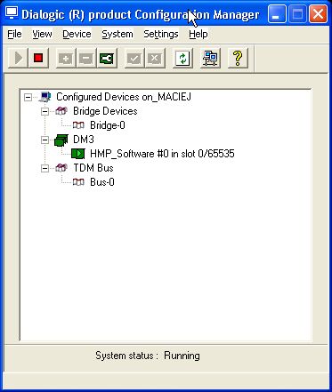

I installed HMP Software, and DCM (no extra configuration).
Then I configured config file and start script.
Should I configure something else?
