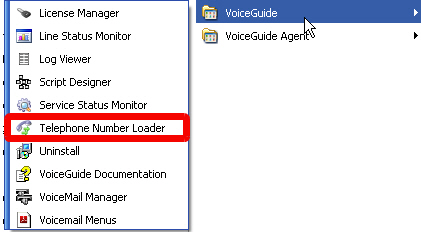

The manual says “the VG Dialer option must be enabled,” but I can’t find it.
It is enabled in the Evaluation version of VoiceGuide, which it appears that you are using now (?).
Got it, now. Thanks. Your manual calls it VG Dialer. Your on-line help calls it Outbound Dialer. And, your software menu calls it Telephone Number Loader. So, it took a while to figure out.
