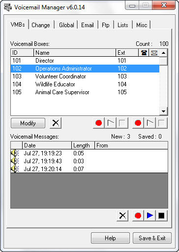

I have a brand new install on Win 7 of VG. The Voicemail manager is recording the messages and I can see them listed in the Voicemail Manager app. I can also see the wav files and can play them in the data VmSave directory. When I try to play them through the app, it gives this error and exits.
What is the error that you are seeing? Can you maybe post a screenshot?

Attached is the VM manager and the error I get as soon as I click play on one of the files.
Please advise.
I think the reason here is that the voicemail manager that still ships with v7 cannot play ULaw and ALaw encoded .WAV files, only PCM encoded .WAV files.
And VoiceGuide v7 for now records sound files by default in ULaw or ALaw, not PCM.
Looks like we do not have a fix for this at this stage. As a workaround the sound files need to be listened using other sound playing software, or by double clicking on them in the Windows Explorer.
