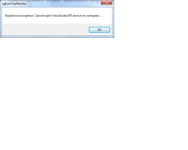

When we try to stop the service. it give error message

Not sure why the errors would be encountered at service stop time. Does the user logged on at the time have Administrator privileges?

The error message with stopping of services will appear if the currently logged in user does not have permissions to start/stop that service.
A workaround would be to start/stop the service using Control Panel -> Administratove Tools -> Services applet.
Then stop/start the "VoiceGuide IVR" service.
The ability of the icon tray app to starat/stop services may be affected by how the VoiceGuide software was installed.
When installing ensure that you use Right Click and select "Run as Administrator".

We reinstall using run as admin, also no good luck, but it can use services to start and stop.

the stop service issue, we use run as admin to install, same result.

To use the VoiceGuide Service Monitor in current version of VG under Win7 you need to be logged in as Administrator. Not a a user that 'is part of Administrators group' - the actual Administrator.
To enable the Administrator account:
Start-> Computer -> RightClick -> Manage -> Local Users and Groups -> Users -> Administrator
Uncheck the "Account is disabled" entry
From http://www.voiceguide.com/vghelp/source/html/install_v7_dialogichmp.htm:
If not running as Administrator then you will not be able to stop and start the VoiceGuide service using the VoiceGuide Service Monitor applet from the icon tray.
To stop/start the VoiceGuide IVR service you will need to go to Control Panel -> System and Security -> Administrative tools -> Services
