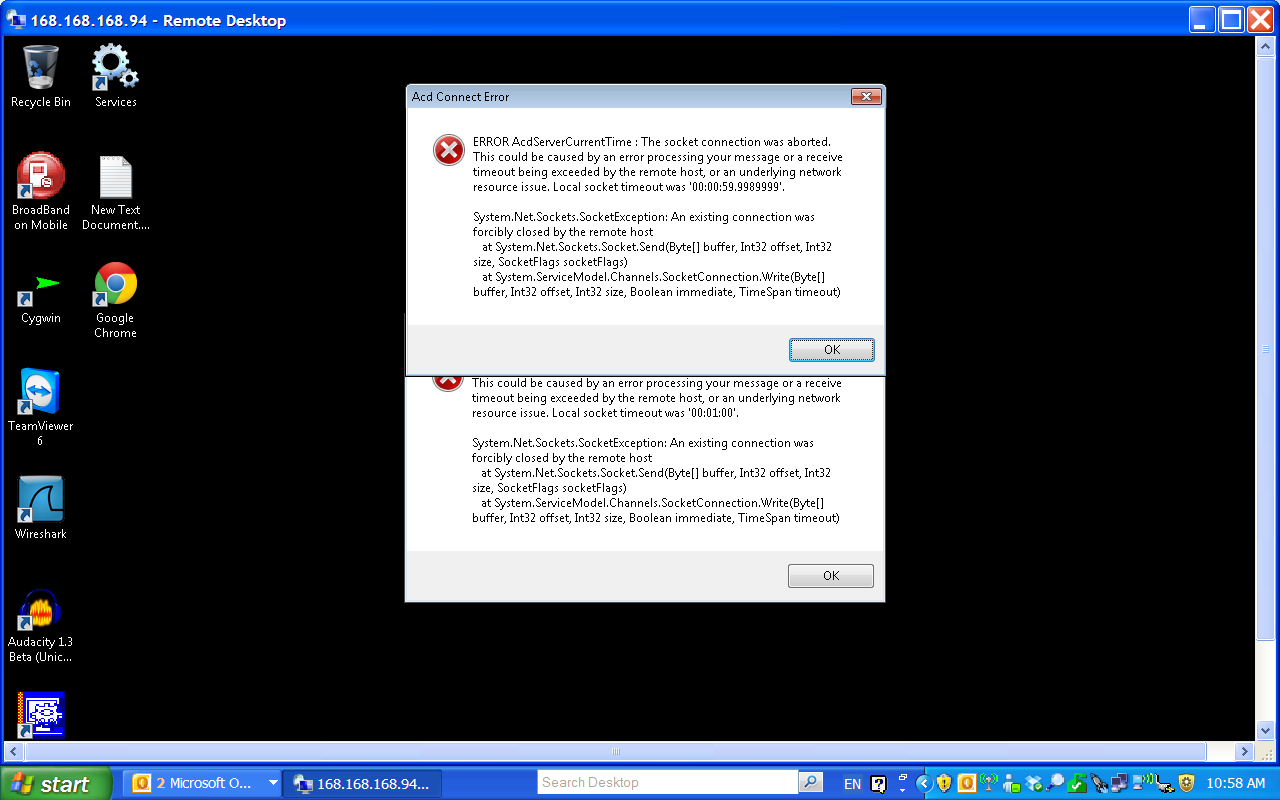

cargoms Report post Posted 11/10/2011 08:43 AM we capture this error message, is it from the voice guide program ? Thanks Cargo MS Share this post Link to post

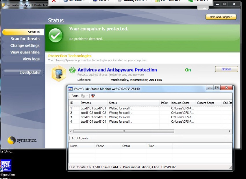

SupportTeam Report post Posted 11/10/2011 10:07 AM This error message comes from the 'Line Status Monitor' application. Looks like there is loss of connectivity between the 'Line Status Monitor' application and the VoiceGuide's ACD service reporting. Note that this reports just loss of connectivity with the ACD subsystem - not with the IVR service itself. Is the IVR lines status still being updated on the 'Line Status Monitor' application? - just place a call into the system to check. A few more questions: Is the 'Line Status Monitor' application running on same system as the VoiceGuide service? Are there any anti-virus apps on this system or any other apps that could interfere with TCP communications? Were any changes done to the .config files for the VoiceGuide service application? Can you post a screenshot of the 'Line Status Monitor' application so that we can see which version of that application is used on the system? Share this post Link to post
cargoms Report post Posted 11/11/2011 12:54 AM 1. the pc , voice board, software , all in one hardware 2. this pc is protected by symantec endpoint 3. now sure if changed, so attach the .config inline 4. also a screenshot, Thanks very much Cargo MS one .config file is as below <?xml version="1.0" encoding="utf-8" ?> <configuration> <system.serviceModel> <bindings> <netTcpBinding> <binding name="NoSecurityNetTcp"> <security mode="None" /> </binding> </netTcpBinding> </bindings> <services> <service name="vgEngine.LineCommandLink" behaviorConfiguration="StandardBehavior"> <endpoint address="" binding="wsDualHttpBinding" contract="vgServicesInterfaces.ILineCommandLink" /> <endpoint address="" binding="netTcpBinding" contract="vgServicesInterfaces.ILineCommandLink" /> <endpoint address="mex" binding="mexHttpBinding" contract="IMetadataExchange" /> <host> <baseAddresses> <add baseAddress="http://localhost:7131/LineCommandLink" /> <add baseAddress="net.tcp://localhost:7132/LineCommandLink" /> </baseAddresses> </host> </service> <service name="vgEngine.PortCommandLink" behaviorConfiguration="StandardBehavior"> <endpoint address="" binding="netTcpBinding" contract="vgServicesInterfaces.IPortCommandLink" /> <endpoint address="" binding="wsDualHttpBinding" contract="vgServicesInterfaces.IPortCommandLink" /> <endpoint address="mex" binding="mexHttpBinding" contract="IMetadataExchange" /> <host> <baseAddresses> <add baseAddress="http://localhost:7131/PortCommandLink" /> <add baseAddress="net.tcp://localhost:7133/PortCommandLink" /> </baseAddresses> </host> </service> <service name="vgEngine.PortStatus" behaviorConfiguration="StandardBehavior"> <endpoint address="" binding="netTcpBinding" contract="vgServicesInterfaces.IPortStatus" /> <endpoint address="" binding="wsHttpBinding" contract="vgServicesInterfaces.IPortStatus" /> <endpoint address="mex" binding="mexHttpBinding" contract="IMetadataExchange" /> <host> <baseAddresses> <add baseAddress="http://localhost:7131/PortStatus" /> <add baseAddress="net.tcp://localhost:7134/PortStatus" /> </baseAddresses> </host> </service> <service name="vgEngine.AcdService" behaviorConfiguration="StandardBehavior"> <endpoint address="" binding="netTcpBinding" bindingConfiguration="NoSecurityNetTcp" contract="vgServicesInterfaces.IAcd" /> <endpoint address="" binding="wsDualHttpBinding" contract="vgServicesInterfaces.IAcd" /> <endpoint address="mex" binding="mexHttpBinding" contract="IMetadataExchange" /> <host> <baseAddresses> <add baseAddress="http://localhost:7131/AcdService" /> <add baseAddress="net.tcp://localhost:7138/AcdService" /> </baseAddresses> </host> </service> </services> <behaviors> <serviceBehaviors> <behavior name="StandardBehavior"> <serviceMetadata httpGetEnabled="True" /> </behavior> </serviceBehaviors> </behaviors> <!-- see: http://msdn2.microsoft.com/en-us/library/ms733025.aspx for information on enabling WCF tracing --> </system.serviceModel> <system.data> <DbProviderFactories> <remove invariant="VistaDB.NET20" /> <add name="VistaDB Data Provider" description=".Net Framework Data Provider for VistaDB" invariant="VistaDB.NET20" type="VistaDB.Provider.VistaDBProviderFactory, VistaDB.NET20, Version=3.4.1.69, Culture=neutral, PublicKeyToken=dfc935afe2125461" /> <remove invariant="System.Data.SQLite"/> <add name="SQLite Data Provider" invariant="System.Data.SQLite" description=".Net Framework Data Provider for SQLite" type="System.Data.SQLite.SQLiteFactory, System.Data.SQLite" /> </DbProviderFactories> </system.data> </configuration> Share this post Link to post
