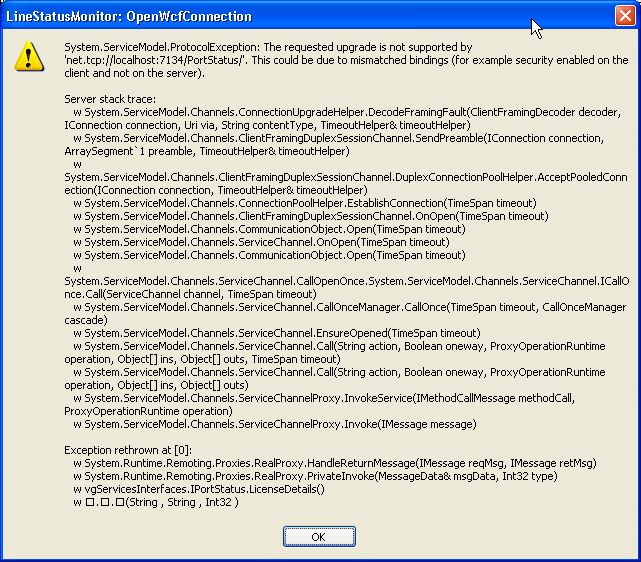

I tried to input net.tcp://192.168.XXX.XXX:7134/PortStatus/ into Address field and connect doesn't work.

After install new vg version line status monitor doesn't work, remote monitoring too.
http monitoring should be addressed to port 131?
Looks like you have an old configuration file on your system.
Would have expected them to to be updated by the new install.
Can you please .ZIP up and post all the .EXE and all the .EXE.CONFIG files from your VoiceGuide directory.
after reinstall monitor working properly.
But not http. any suggestions?
