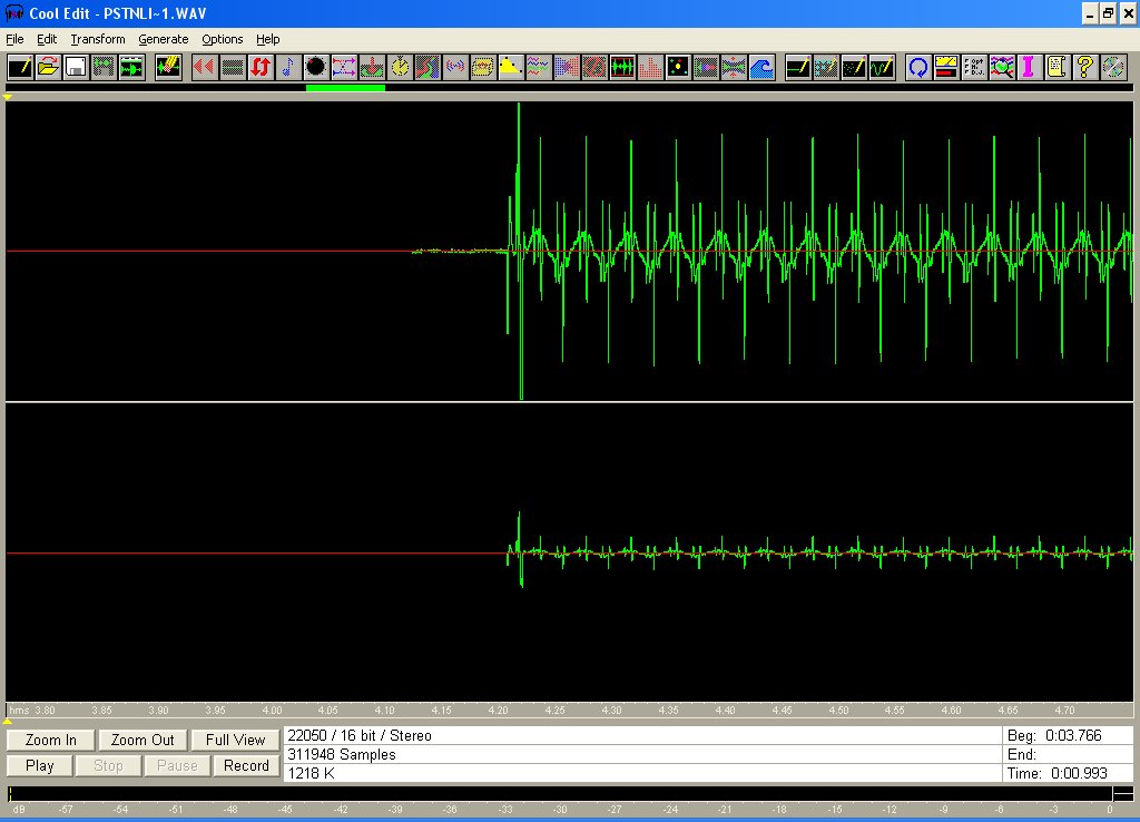

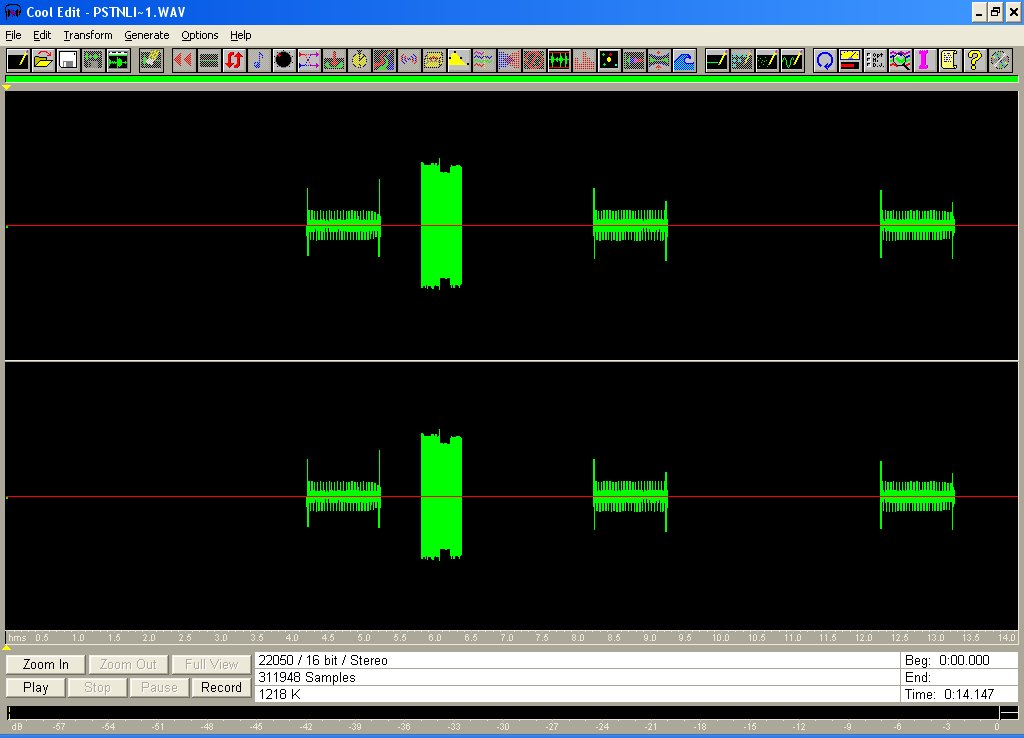

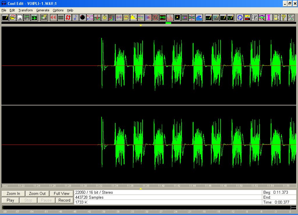

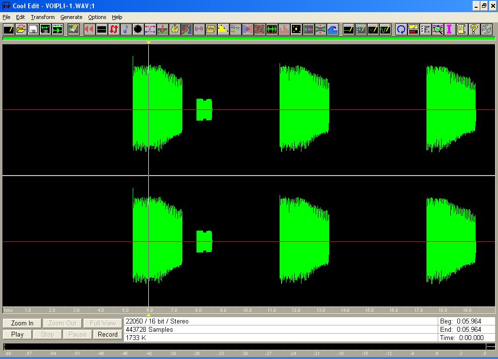

Trying to analyze the cause for the problem, I put an audio monitoring device on both lines and it seems that's there's definitely a difference between the analog ring signals on the different lines. I have captured waveform pictures as well as audio recordings of the two to demonstrate what I mean (3 rings total + callerID data between the
first two rings) and can upload here if requested.
What can be seen is that the PSTN ring signal is one-second length bursts of a 25Hz continuous sinusoidal signal with 3 seconds pause in between the rings, while the VOIP box's ring signal is two seconds length with 4 second pause in between, seems stronger and is actually made of a higher frequency signal (about 2KHz) chopped into small chunks at about 40Hz rate. For clarity, I've attached some images to demonstrate what I've described.
My guess is that some voice modems firmware cannot adapt to the different cadence of the VOIP ring. The exact way the high voltage ring signal is created (continuous 25Hz vs chopped 2KHz) shouldn't make the difference because it's rectified and converted to DC pulses anyway in the modems analog ring detect circuit.
