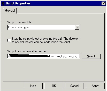

iTime Report post Posted 08/08/2012 08:45 PM I have applied the patch to the server. Thank you. I will let you know if there is a further issue. Quote Please ensure that if running a VBScript in the the "After Hangup" script, the VoiceGuide module is not set to wait for VBScript to complete. I do not know how to make "Post Hangup" script not to wait for VBScript to complete. The screen (below) does not have that option. Am I missing something? Thank you. Share this post Link to post
SupportTeam Report post Posted 08/08/2012 09:18 PM The setting to not wait for completion is done in the module's properties please see: http://www.voiceguide.com/vghelp/source/html/modvbs.htm Share this post Link to post
iTime Report post Posted 08/08/2012 11:59 PM Oh, I thought I had to set that on the Property screen. I did change the option for the VB Script to "Do not wait..." Thanks. Share this post Link to post
