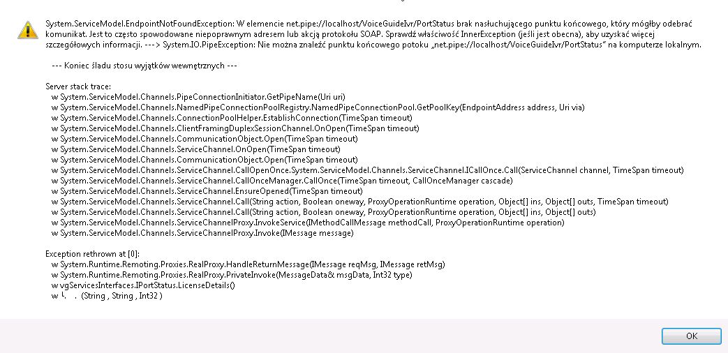

Sometimes after restarting VG line status monitor not connecting to VG.
VG answering calls.

It happen each time after restart VG.
I check service, VG works but line status application can't connect to VG service.
After Windows restart all working properly.
