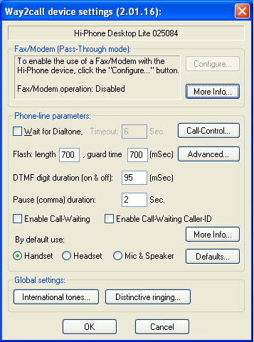

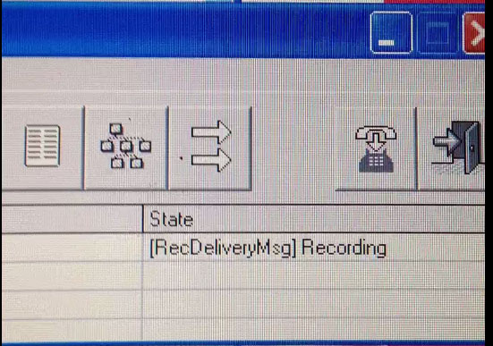

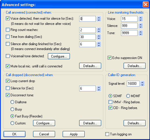

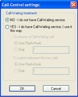

I am unable to record and deliver voice message, Iused. (Please find the attachment of modem settings, and VoiceGuideScreenShots)
Sample Scripts: Message Record & Deliverto Specified Number. ( Sample Script "Message Record & Deliver"
Application: VoiceGuide 5.2.5049 TAPI
Modem: way2call desktop USB lite modem, And modem driver versionis 2.01.16 (Please find the attachment of modem settings)
OS: Windows XP with SP3
Telephone line : 1. Bangladesh PSTN land line. 2. AndPanasonic KX-TDA600, KX-TDA620.

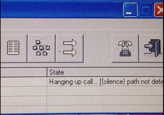

If you are using these scripts:
http://www.voiceguide.com/support/DeliverMsg.zip
then please add this path to the RecDeliveryMsg module:
on {silence} goto [Deliver Message]
Right now if the recording finishes due to silence the script stops as there is no silence path to move script to the Deliver Message module.
180049.98   5 path  {silence} not found
180049.98   5 rv    lg add [Hangup Time]{1/10/2013 6:00:49 PM}
180049.98   5 state Hanging up call... [{silence} path not defined]
