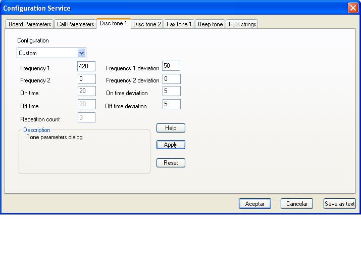

Can you please post a screenshot of your current configuration of the Dialogic TSP's settings for the "Disconnect 1" tone.
I'd try decreasing repetition count to 2 (or maybe even 1).
All other settings are OK.
Must say its a pretty strange disconnect tone. I have not seen the cycle of 3 short beeps followed by a longer pause signify a disconnect before...
