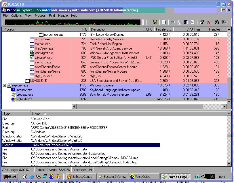

The latest advice was to take a screenshot and zip up some trace files. However, as our server generates lot of traffic during the day, it is unfeasible for me to shut the server down, switch on the traces, do some test calls, then switch of the traces again.
So instead, I have done a test late at night which involved placing a call into the system and letting it run for a while. Sure enough after a few minutes of activity, we have a 'Non-existent process' listed in Process Explorer. If I were to leave the server running, over a period of a few days there will be a few thousand of these clogging up the system. The only way to resolve this is to bounce VG.
So, with the picture and trace files relating to this non-existent process attached, over to you!

It looks like we were able to identify the cause of the handle leak. The leak was happening when a VBScript was ran before call was answered. (Handle was used to track VBScript progress and VG was loosing track that there was an existing open handle at call answer time).
Attached .exe should fix this problem. Please update system with attached .exe and see if this resolves handle leaks for you
Note that under some circumstances there may be handles created by VG which may point to non-existing process, but their number should be upper-bound limited to no more then twice the number of lines controlled by VG.
Thanks for the screenshot and traces - both were needed to track this one down.
VgMulti_6.0.3181.zip
