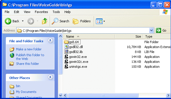

Guest u4910 Report post Posted 02/14/2009 06:11 PM OK. Tif works, now I'm trying PDF. I installed GS and the help said to install to c:\program files\voice guide\bin. I did that and it made a gs directory there installed GS. I tried to send a PDF, no luck, so I copied from the gs.864/bin directory below that upto the voice guide/bin/gs directory. I attached a screen shot and log. Is there something I'm missing? 0101_1006_vgEngine.txt Share this post Link to post
SupportTeam Report post Posted 02/14/2009 09:48 PM Could not find any ".pdf" string in the attached log. Looks like a new thread was started on this topic here: http://voiceguide.com/forums/index.php?showtopic=6028 so please continue .PDF related posts in that new thread. Share this post Link to post
