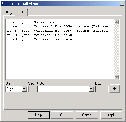

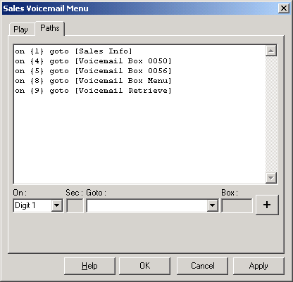

An example below shows how the paths can be defined:
You can indicate to which module in the script the caller is to return to after leaving the voicemail system by appending Return [module title] after the path specification. The Return option will need to be typed in by hand. eg:
Once the caller has finished recording and/or retrieving messages and presses '0' to exit from the voicemail system, the script will then go to the module specified in the Return option. See here for more information on the Return option.
